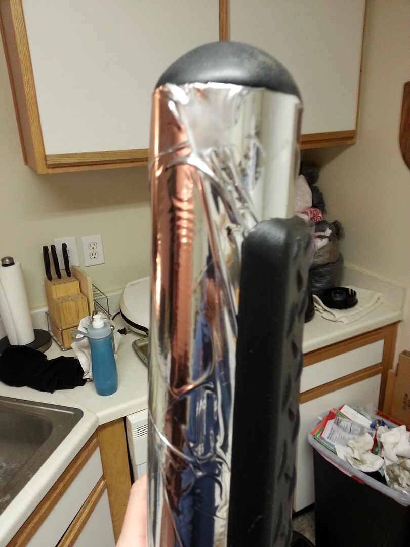

So first off, this RVinyl Chrome wrap doesn't work like normal vinyl. You don't want to use heat on this stuff, or it ends up like this.

You can see in that picture an area where I jacked it up. This film supposedly has air release and should fix that. We shall see in the morning.
I put it back on the Jeep just to see how I liked the look. I do like the chrome, and the vinyl looks great for chrome. However, I didn't do very good job with it, and so it didn't turn out as well as it could have. I have no doubt a professional with this film could make these look flawless, and fantastic, but the RVinyl chrome is somewhat difficult to work with.
Overall, the product is good, with awesome looks - it looks as good as a lot of OEM "chrome". But it's hard to work with, so unless you are pretty skilled with it, I'd limit it to smaller areas. And don't try to use heat on it.
