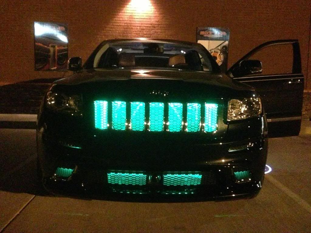

so Im getting Green LEDs in the front grille (upper and lower), will post when done on April 8th.
Found someone that can:
1. tie in the srt DRLs to my Overland DRLs so both on at same time.
2. Replacing Overland DRL bulbs with canbus led white as well as the SRT Foglamps.
ok...green leds look awesome...indeed the overland DRLs CAN tie into the SRT DRLs perfectly allowing both to come on together contrary to what the local jeep dealer bodyshop told me. The only issue is the new canbus white led in the overland DRL ..well lets just say "the drapes dont match the carpet". So the shop is looking for a better match of white led to match the srt drl...stay tuned for photos!
More pics to come when I can, this from the installers on the green backlit grille...Im loving it!
