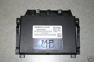

I came across this black plastic box with a Siemens Label on it, box is around 4"x4"x1". Looks like the soundproofing has been cut above the steering column and this box wedged up in there not secured by anything. Just looks out of place to me, like installed afterwards. Anyone else have this thing? I have an 05 Laredo by the way.

Mine doesnt have that box that i can see. Its not the security...I have that and it says Mopar security right on the box. Its not the uconnect module either...thats a Johsons controls box and is much larger.
Get the mopar part # off of it and enter the number at moparsupercenter or one of the parts dealers and see what comes up.

Actually from what i have read online seems to be a Transmission control module i believe...
Timmy has an 05-06...so its not the black box unless it was added
It def looks added afterwards. It has two harnesses, one on each side. Its just wedged up in there held by the sound proofing. I'll start googleing numbers off it. It says Siemens on it, isnt that like a phone company? I trace the harnesses from it and the plastic clips are not engaged in anything, like the harnesses were moved.
It is the transmission control module.

According to the part number that is on it, it is a TCM.
hmmm...I though the tcm was under the center console. i entered the numbers and didnt get anything
I found some info about that part number on LXforums
Ok, so its supposed to be there then. Just looked thrown in there out of place. I didnt think Jeep would have a major componant just wedged up in there not screwed or fastened down. Unless its been replaced maybe?
^^^^^^ that would be a reason why its not secure, been replaced.

That is your TCM and it will be a EGS52 or 53. There's a plastic tray up above your steering column the it snaps into.

Awesome, thanks. That def looks like it. Im going to try and secure it in better.
