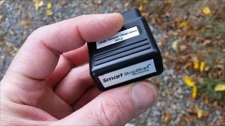

After several weeks of work, I have created a prototype OBDII module that memorizes the last STOP-START OFF setting and restores it when you turn on the ignition on your 2016 or 2017 3.6 liter Grand Cherokee.
I expect to start shipping them in October or November.
There is a sign-up sheet on my website so I can gauge the size of the initial production run.
It also memorizes and restores the state of the SPORT button!
Here is the sign-up website: www.smartstopstart.com. There is no cost or obligation to sign up for notification of availability.

SIGNING UP NOW!!!!
This is awesome! I looked into how that sensor works, and yes, it is on the CAN bus so any type of hotwiring it would only work for that cycle. Your plug in would be perfect and less intrusive. I also sent a second complaint into Jeep just to add to their "numbers". The answer yet again was that this is a fuel economy feature that "cannot" be changed. I call BS.

The best solution I've found for my 2017 GC is the plug in module found at Smart Stop Start - Home. It costs $125 and just plugs into your maintenance jack by the parking brake peddle. Installs in about 3 seconds. It remembers your last ECO, ESS, and SPORT settings so you don't have to push the buttons each time you restart your jeep. If you want to change the settings just press the button(s) and it will remember the new settings. Well worth the money, given the annoyance factor of this poorly thought out design. Especially when your AC shuts off at each red light in the Texas summer! ESS = Exceedingly Stupid System
NOTE: You can disable the ESS buy disconnecting your open hood sensor but this will also disable your remote start feature. The delay stop settings in your settings menu are for your radio and lights not the engine.

I've had mine since I bought the Jeep in March and love it. Set it and forget it, ECO stays off as well.

Any long term updates regarding the modules reliablity and if it has affected any other function on the vehicle, throwing codes, etc. The web site advises to remove the module if you take you car in for service. Anyone have feedback from a dealer regarding the device? Thanks in advance.
#23 ·
No issues over the past couple months. Dealers will tell you aftermarket washer fluid will void the warranty so I'd never waste my time trying to explain this to them, most service advisors are clueless. Just pull it if you bring it in. I just had the oil changed and didn't but nothing was said.
