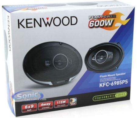

In the front doors will go Kenwood KFC-6985PS. I used these in my 2015 and to be honest, I didn't really expect the clarity and the pounding power this Alpine amp and these 6x9s would deliver. I was literally blown away and is better than any Alpine or Harmon Kardon factory system available in these vehicles today, with the exception of the sub-woofer of course. That is for later and done professionally.

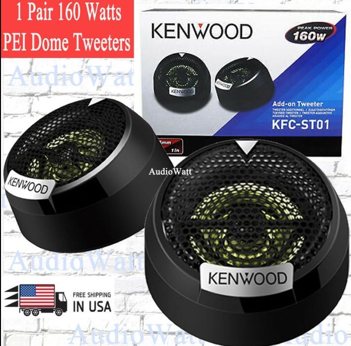

For the door tweeters, will be Kenwood ST-01. I believe these have built in crossovers and can be wired directly from the + and - of that door's Kenwood 6985PS.

I don't want to "rain on your parade", but stop and consider this....You're not only installing 3-way speakers in the lower front door location, you're also installing separate tweeters in the upper front door location. That's a LOT of high range sound you'll be producing.....
I hear where you're coming from, but understand that I have already done this in my 2015 JGC. It sounded absolutely phenomenal to the point where my friend in his 2015 overland with the best system you can buy in that year, was jealous. In a good way. My bass, mid and treble settings on the EQ never had to leave the center position. Highs were crisp, clear and effortless but never intrusive. It's hard to get proper treble highs in a system. Even more so than bass. Trust me on this as I have done this exact setup before. Parade will go on even on account of rain. :)
