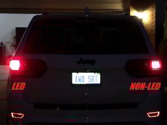

Thanks for sharing the video. It is the same model that is being sent out now. Very popular and sold out again. It is in stock in a few days and everyone has been notified. So if you do order now it will deliver in a few days:
The overall brightness is much brighter than OEM and many competitors without any need for resistors. Meaning that extra light that is in the housing that shines past OEM really makes a big difference along with the quicker light-up times to alert others when you brake and signal.
