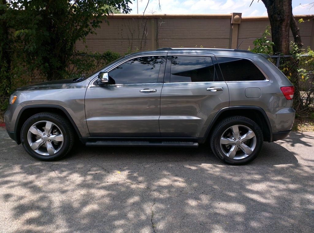

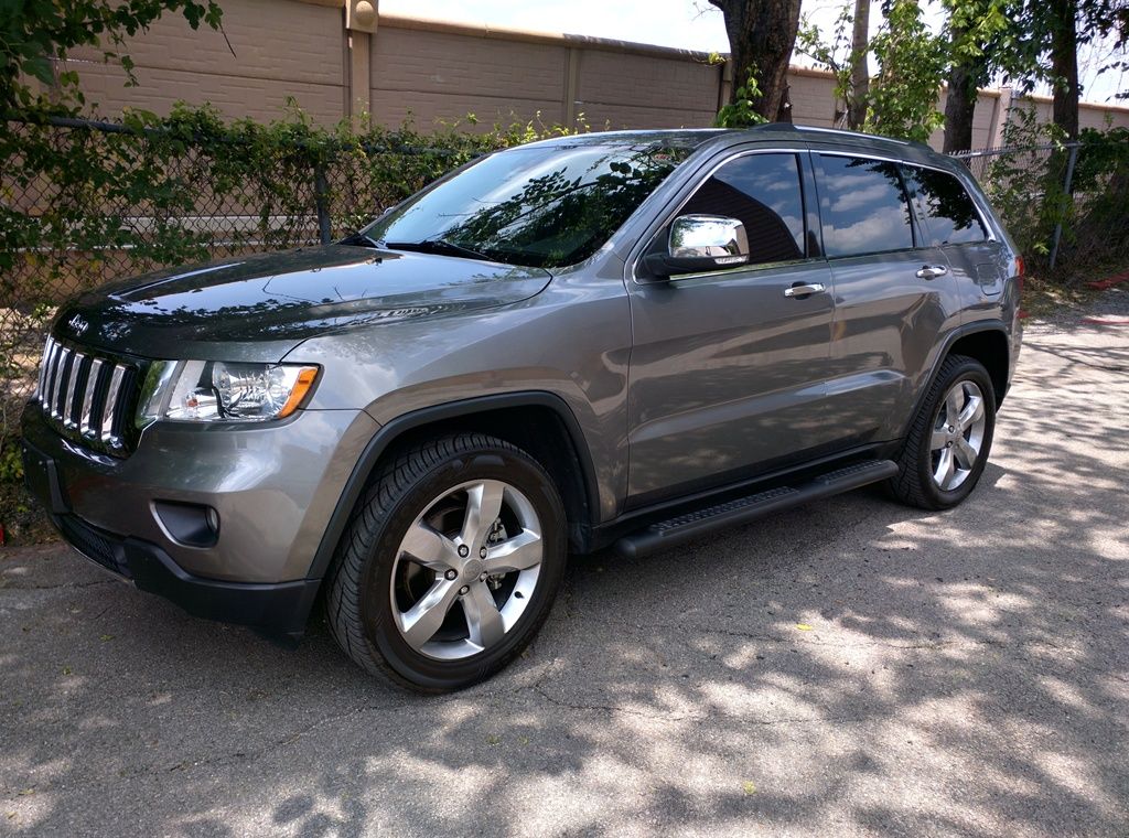

So I did this mod a few days ago: Used only fishing line to swipe off the all of the emblems on the my Jeep. I know many say to use a heat gun, but it's 95* in Texas and 10lb fishing line ($1 from Wal-Mart) worked fantastic. No issues at all, but it did snap a few times - might want to try 15-20lbs if you want to avoid the snapping, but it's no big deal at all, it was like a 200ft roll.
For the extra adhesive left, I literally took the pad of my thumb and rolled the big chunks right off. Was mildly rough on the finger tips, just due to the sheer volume of all the lettering :lol: . For the tiny parts/spots, I just used some bug and tar remover. Let sit for 1-2 minutes and it literally wiped 90% of it off on one sweep.
Whole thing took me under 90 minutes to remove the "Limited" "4x4" "Grand Cherokee" side molding x2, Rear and Front "Jeep" Emblems, to peel all the glue/clean it up, and attach the gloss black front/rear "Jeep" logos. Hardest one was the Rear emblem. Used some fishing line to snake behind it and than used a plastic trim tool to very slowly pry back, saw, pry back, etc.
Think it came out pretty well.
